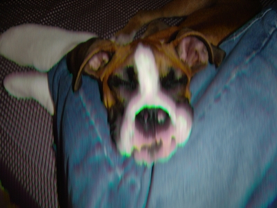

Here is a picture to show the results of the repair.

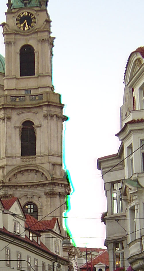

"Me too" on my DSC-P92--same green flare. The issue cropped out in the field in Europe. Lots of ruined images, QQ.
One thing I noticed: The effect seemed to show itself after switching from image review mode to shoot mode without turning off the power. Powering up into shoot mode seemed to avoid it. Later it went bad altogether.
The attached example [Svatého Mikuláše, Malá Strana, Praha] shows an odd lateral pixel-shifting I got along with the unusally bright lime color halo time. (Imaged cropped for size.)
